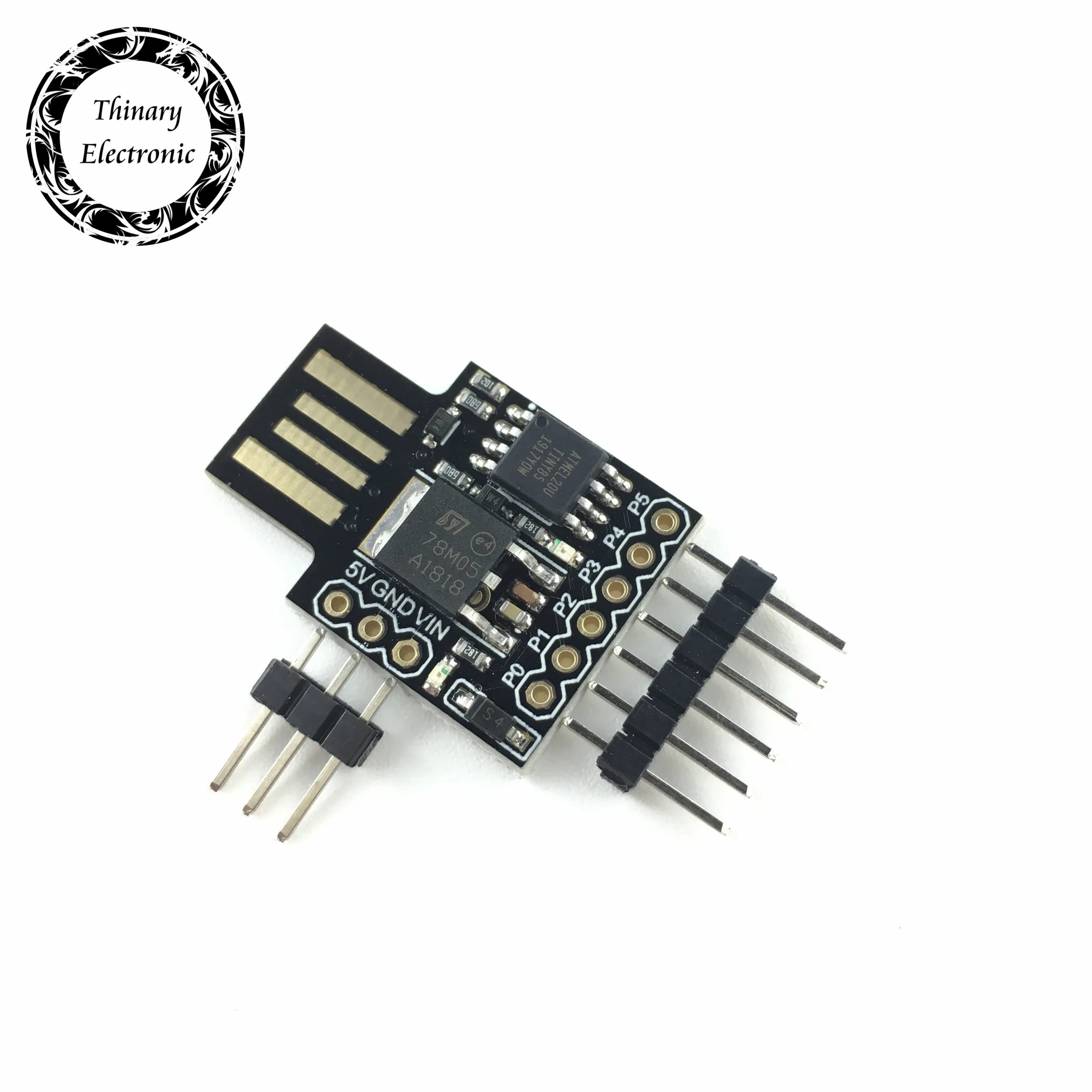

One of the cheaper processors I know of is

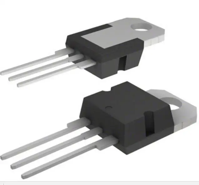

H-bridge

I’m not sure what the price sums to.
This is just one option, moving things are always fun.
