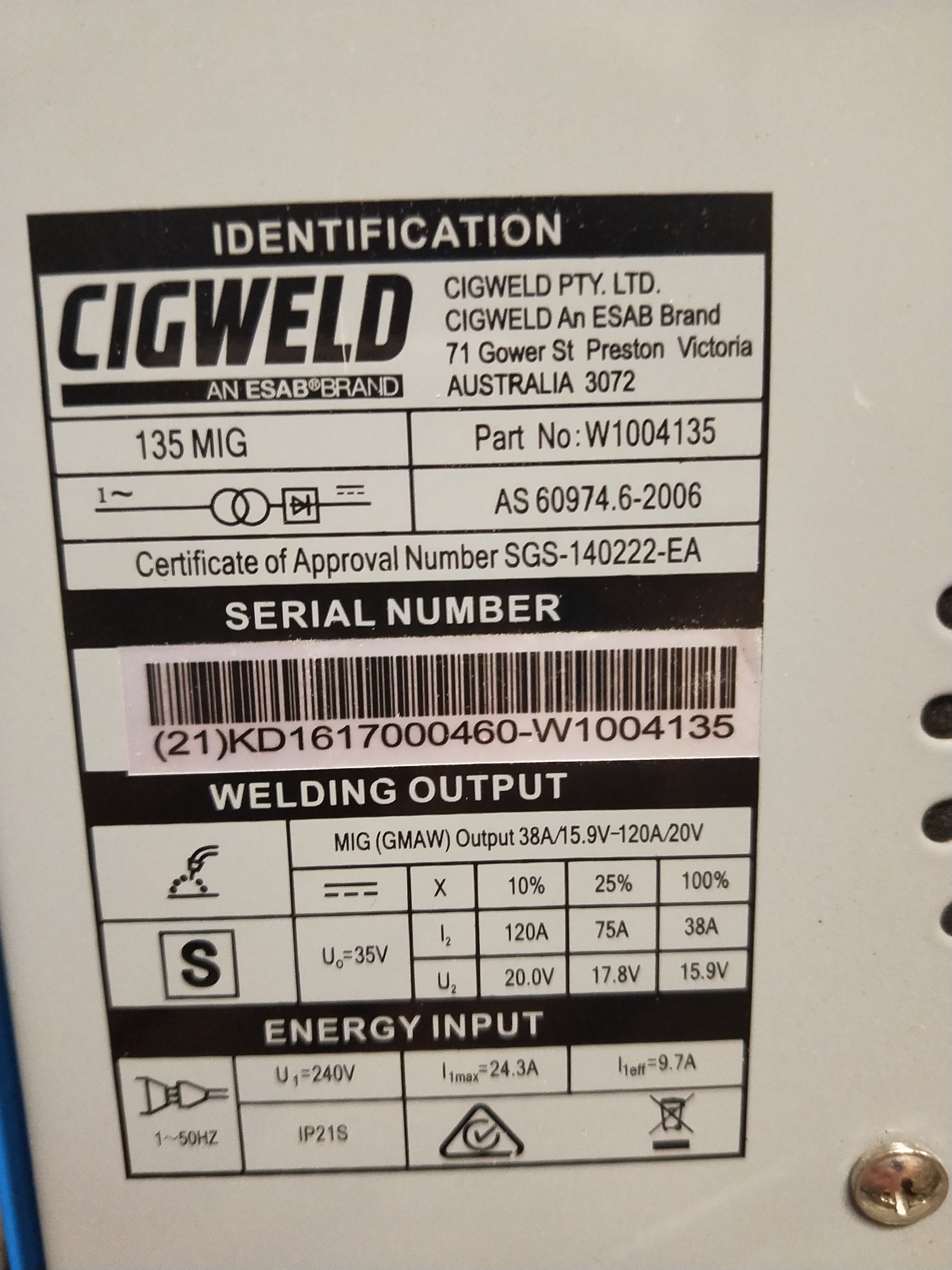

I’ve called Total Tools and it is a part that we buy a replacement for.
I need to get the exact product number (apparently on the back of the unit) before they are able to give me an exact price.
If anyone happens to be in the space before me - could you please post the part number here?
(we have an earlier model of this: https://www.totaltools.com.au/96748-cigweld-weldskil-135-mig-welder-w1004135)
Hi All, good to hear that we can hopefully replace. @crashman39, if possible at the Pi jam tomorrow could you take a look at the back of the welder and post that part number?
yep i can do that
Here it is
