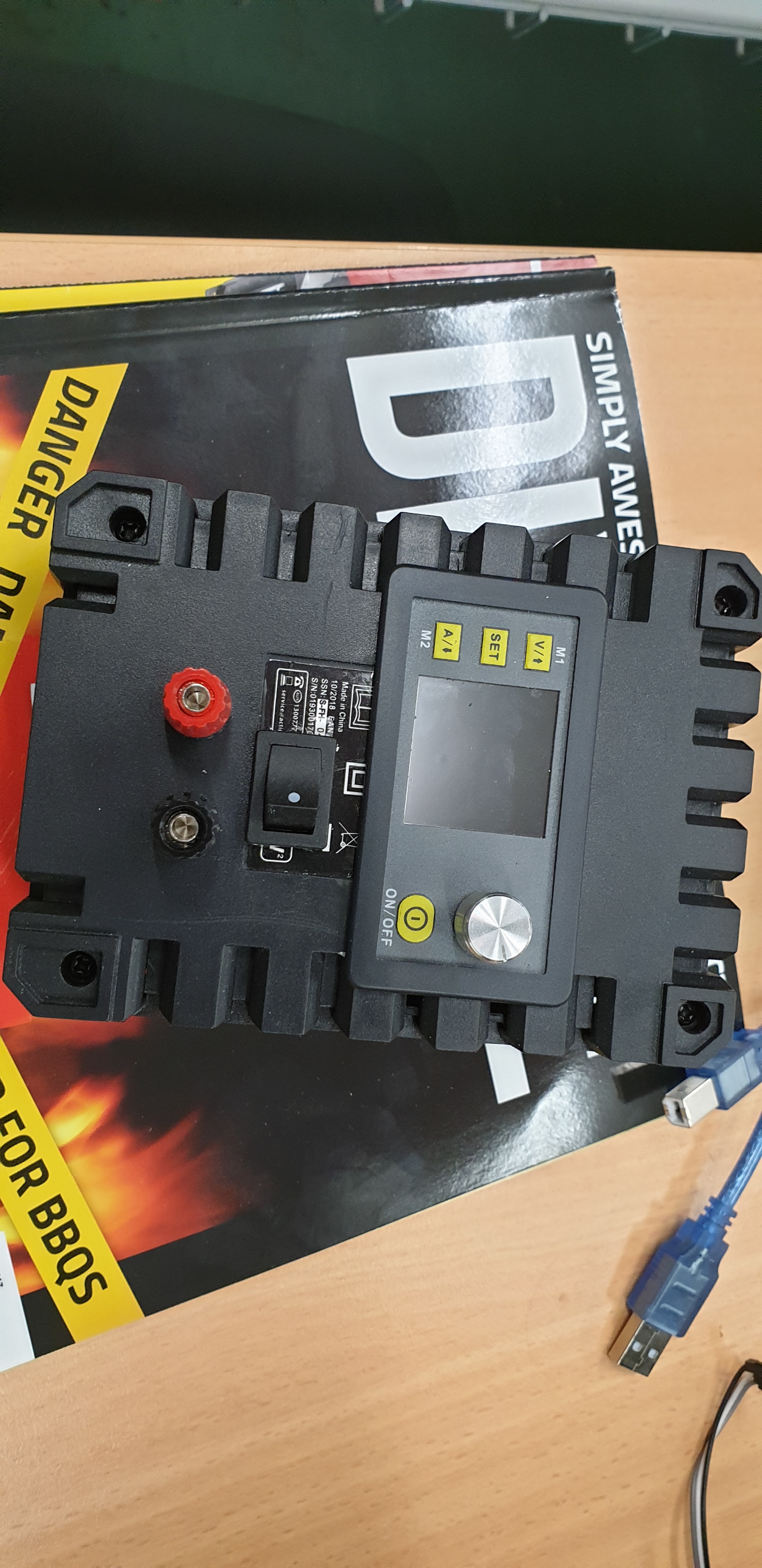

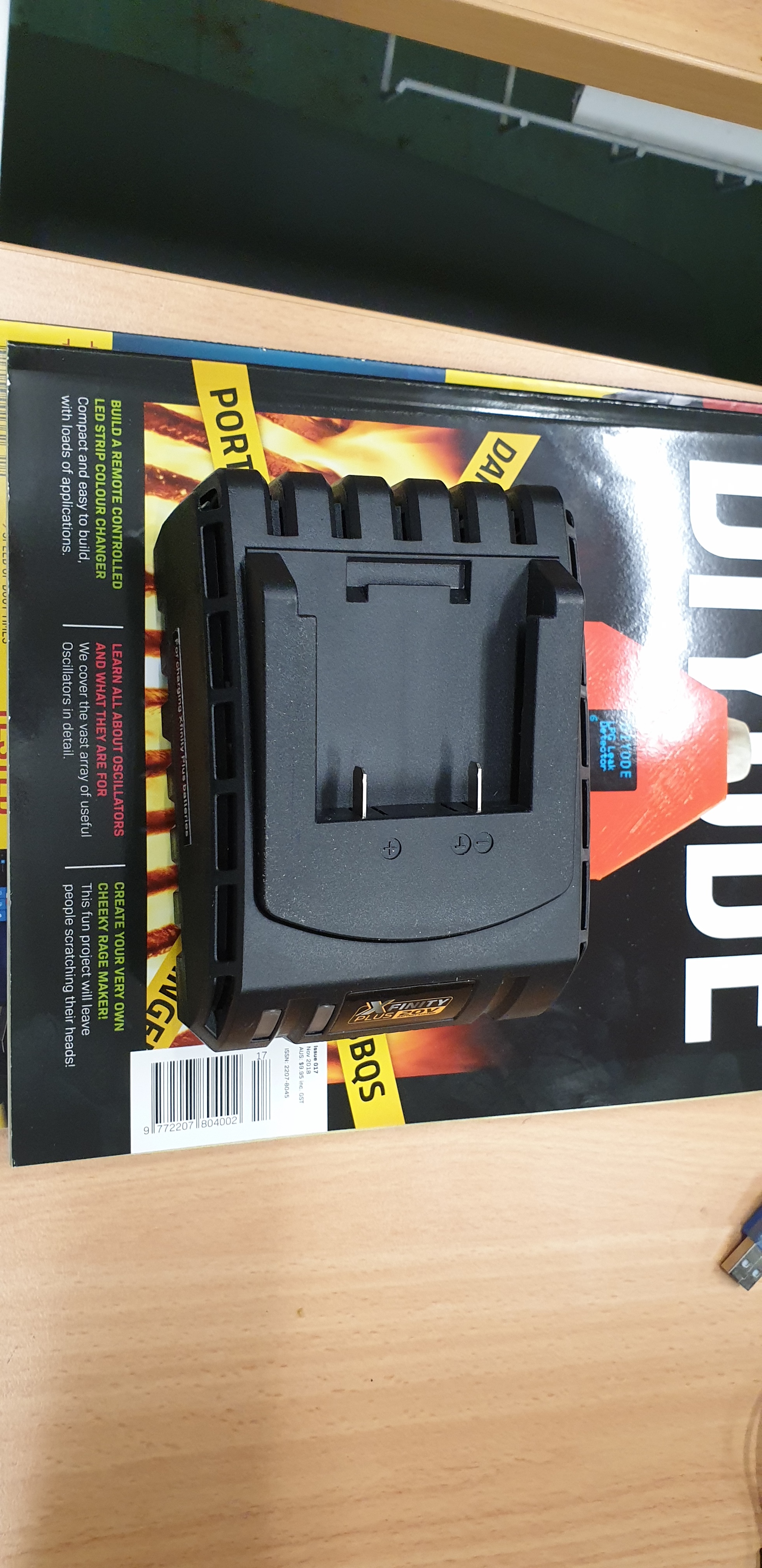

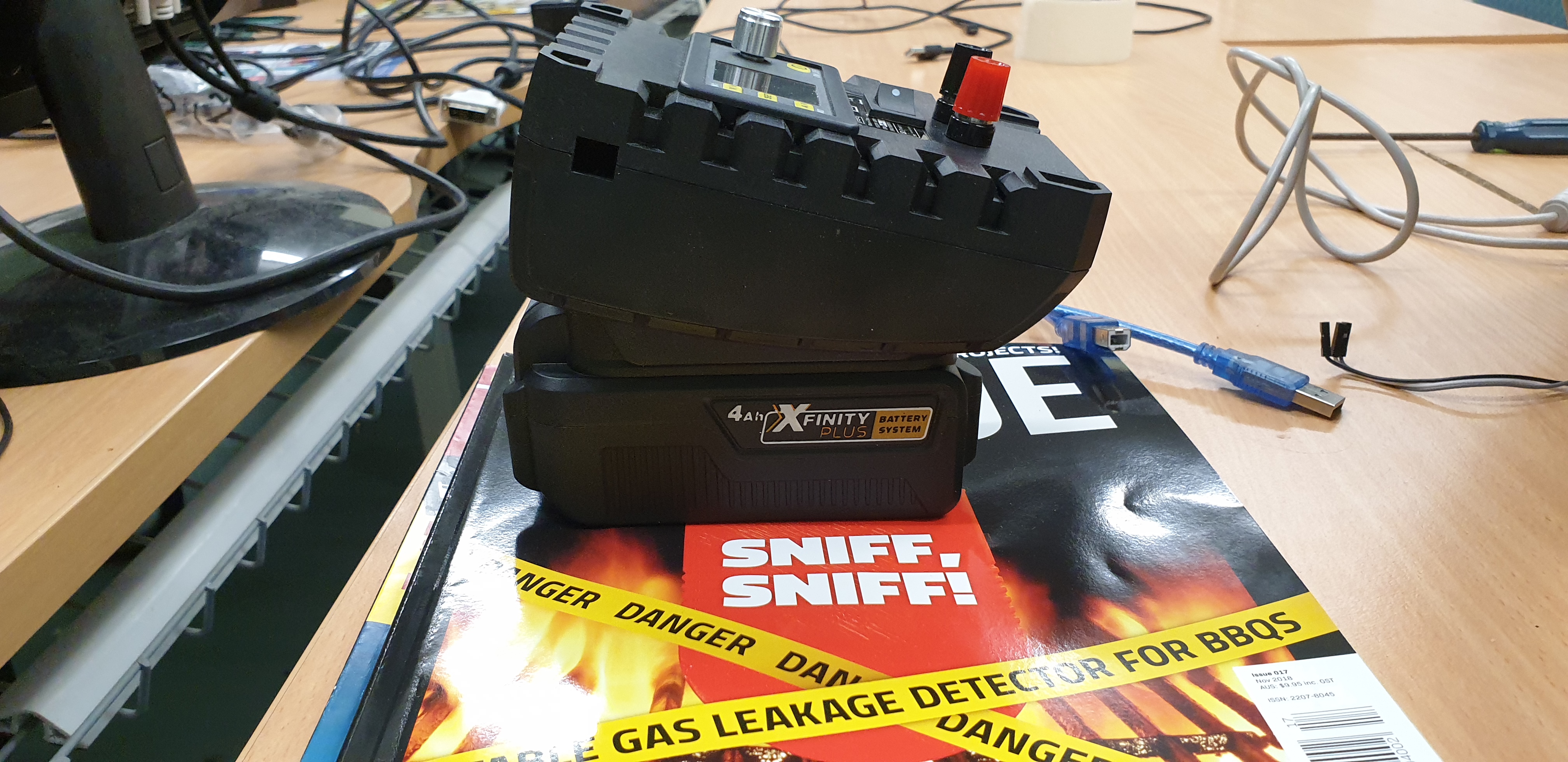

This project was to build a portable power supply in a (gutted) Aldi Xfinity battery charger, which can be simply plugged into a battery module (a 20V 4Ah here). Naturally I have a second, unmolested, charger to top up the battery. Good thing Aldi were clearing the chargers very cheaply.

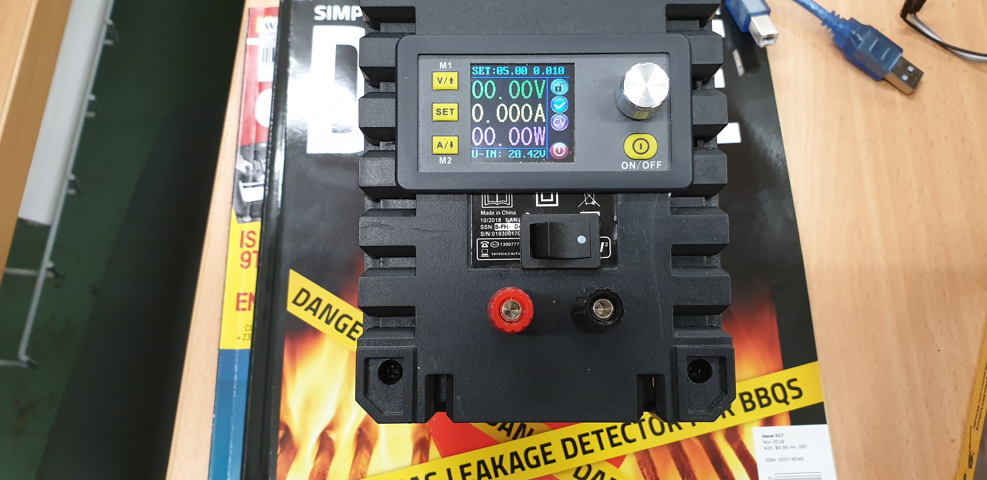

The module is a RuiDeng DPS3005 (commonly available on aliexpress) which can drive 5A up to 30V (but not from the 20V battery here).
The (ABS) case was cut with a rotary tool (a Dremel kind), a drill and files.

@Amr_Tawfik, I want it as a general utility device whenever I need power away from the bench (where I have a “proper” power supply). I usually need 3.3v, 5v, 6v and rarely higher. Current limiting is good to have when hacking.
This is a very cheap setup, so as for reliability…nuff said
