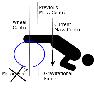

It is worse than tripping over while walking as the rider can not WheelForceDiagramCrashV2
push against anything to try and recover or reduce their rate of descent.
Normally the rider is warned and strongly encouraged to dismount before the battery goes flat but on many wheels battery protection has been prioritised over rider protection which can lead to a shutdown without warning. Wheels designed this way and fitted with low quality batteries can shut down at any time but even with good batteries they become dangerous as the batteries age. A rider is only likely to be aware of a rare and mysterious catastrophic failure on a wheel that was for a long time safe. Early battery replacement with good cells will avoid shutdowns.
