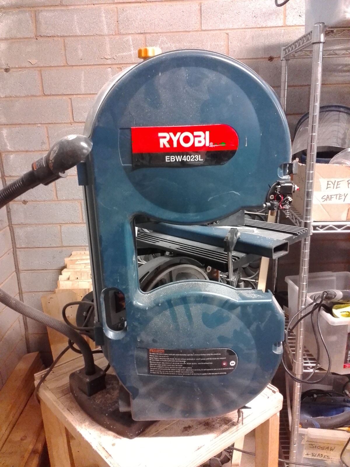

Ryobi? What’s the model number?
The model may be bs230, will confirm.
The blade seems to be 59.5 inch / 1512mm long, 6mm wide, 14tpi
The model is EBW4023L
